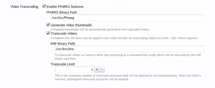

In order to generate video thumbnails & use the Transcode videos option, I need to enter a value in for the FFMPEG & PHP Binary Paths.
How can I find out these paths? (I'm running on centos if that helps)
Thank you kindly in advance.
You will need shell access.
For FFMPEG you will first of all need to make sure FFMPEG is installed. You should be able to install that via yum or download it directly from here: FFmpeg Static Builds
We cannot really provide specific support with installing this or getting it set up, but that should be a step in the right direction at least.
Once installed, the easiest way to get the paths you need is to use the "which" command if it is available:
which ffmpeg
which php

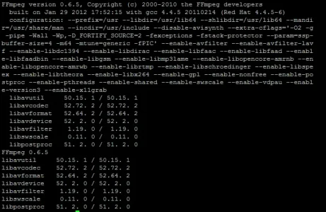

It seems that I installed a rather old version of FFMPEG, below is the data from the /usr/bin/ffmpeg -version command:
Any ideas on other things to check?
Without a doubt I'm certain you need to update the ffmpeg version.
Download the latest release there. Extract the archive and copy the ffmpeg executable within and replace the one on your server with it.
