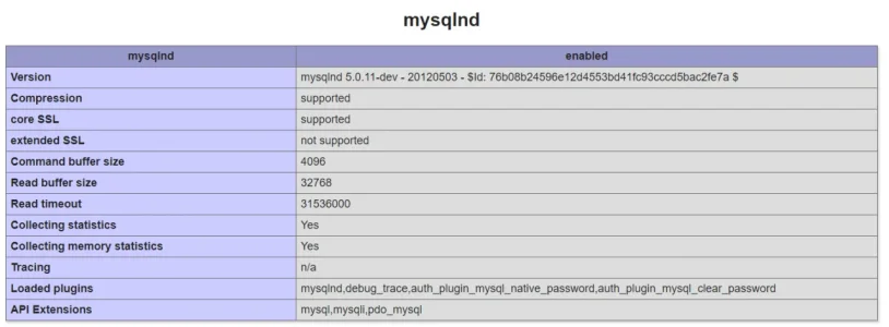

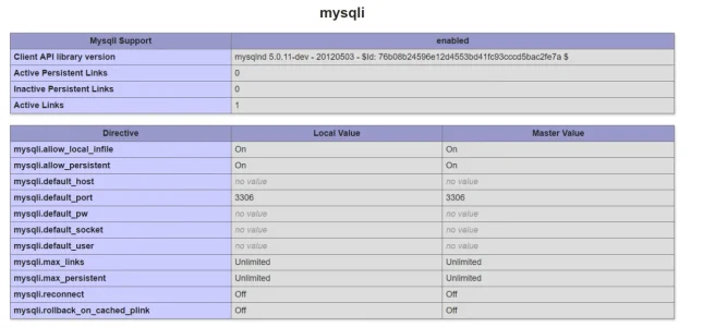

What version of MySQL are you using? PHP?
Can you look at your PHP info and report all of the info from the mysqli section and, if present, the mysqlnd section?
