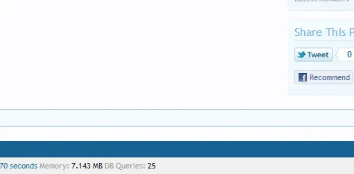

Different requests can have different query counts (eg, with new sessions or caching).
Also, the number on the regular page may not include everything, as it's rendered before the final template is actually rendered. The debug page does not have that limitation.

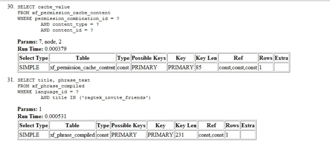

It was the same request BUT it's because of the uncached phrases from the navbar tabs.
If i deactivate them, it's only 1-2 queries more as on the frontpage
