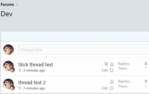

This is what a stickied thread looks like on default style.

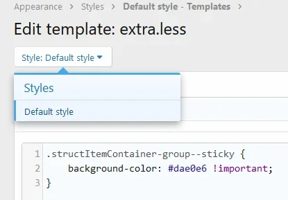

Here is my extra.less
As you can see this is the only style and this is all I have in extra.less

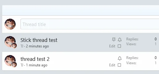

No issues here: https://db76df28bf7ba8d3.demo-xenforo.com/223/index.php?forums/main-forum.2/

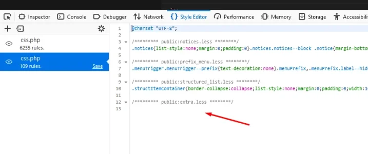

This is showing up blank even though extra.less is populated, so something is not going through.
