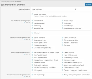

But, Brogan is correct, you have to be a moderator to see the approval queue. You also have to have the specific permissions AS moderator. Found here: admin.php?moderators/super/1/edit Looks like this:
