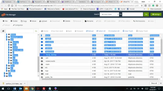

Right now, that site seems to be working somewhat, but without rendering or delivering any type of actual imaging or formatting. See attached.
Previously, it was showing like the default install. Same is true for the main path and for admin.php. Now, it all looks like the attached file, just a white page with links presented in a hierarchy that would make sense if it were shown with some type of formatting, etc.
