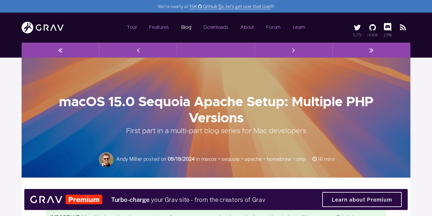

This is the process I follow to set up my dev environment:
It sets up various PHP versions from 5.6 up to the latest using Homebrew and includes a simple way of switching versions.
I understand your recommendation and will definitely work on it to make it compatible with the latest PHP version.
Meanwhile, I think the above link will also work with Mojave 10.14.
Yeah pretty certain it will. I've run various iterations of that guide over several years. It hasn't changed much in that time.
