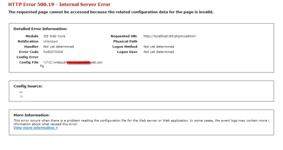

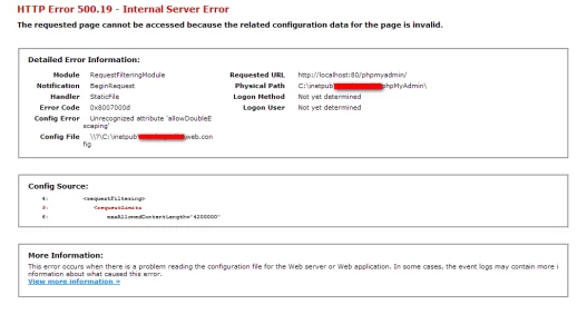

First thank you for helping me, really appreciated :)
but this is what i'm getting now
Post your complete web.config file. I think you already have some parts in it and what I am adding is causing the errors because of duplicates.
What you can do is rename the current config file and create a new one with the contents above.
this is what i have
<?xml version="1.0" encoding="UTF-8"?>
<configuration>
      <system.webServer>
         <security>
            <requestFiltering allowDoubleEscaping="true" />
                  <requestLimits maxAllowedContentLength="4200000" maxUrl="160" maxQueryString="20" />
            </requestFiltering>
          </security>
       </system.webServer>
</configuration>

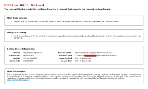

yup it is enabled but i get back the first error sigh :(
HTTP Error 404.13 - Not Found
Increase the numbers until it works. 4200000 = file size of 42M. If file size is bigger increase it to 420000000 which is 42G. Keep adding a zero at the end until it works.
ahhhh yessssss that worked :)
i owe you 2 beers man, thanks soo much (y)
