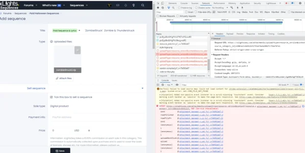

Seem to have an issue that only affects a few users. When they try and upload a file via the resource manager, it gets to 100% then comes up with an error.
Looking at my server logs, it states:
[proxy_fcgi:error] [pid 29134] (32)Broken pipe: [client 193.116.243.173:62125] AH01075: Error dispatching request to : (sending stdin)
They have provided me we a screenshot after pressing F12 which shows this:
They have also recorded the process here - https://drive.google.com/file/d/1Ko7S8FXcc0Zp8ceyKKXS_aqQIhVdu9rf/view?usp=sharing

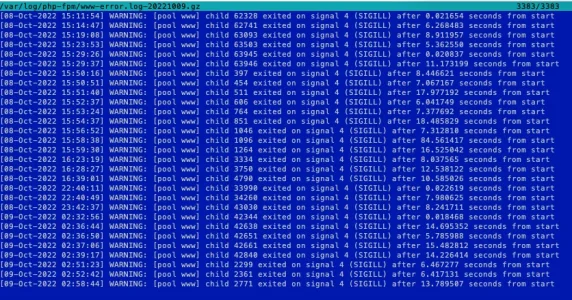

Maybe stuff like this that is still showing up with 8.0.23 (just enabled opcache with it)

I'm battling a "similar" issue, but mine involves using the ACP to upload updates to add-ons or even XF's actual updates. And it didn't start happening until I moved to another VPS instance. I know it's going to most likely be a PHP setting I modified... just have to figure out which one it is.
Mine is caused by the PHP process apparently getting killed and then the site gives a 503 error - but as I said, it's from the ACP.
Have you actually examined your PHP logs?
Thanks for the reply. When I started this thread it was a few users, however now it's myself included!
Latest XF and XFRM. Attachment size settings have all been increased in the ACP.
Attached a file (335MB), however once at 100% and I click on save it says "Opps we ran into a problem, you must upload a file"
In my server domain error log I get:
[proxy_fcgi:error] [pid 26086] (32)Broken pipe: [client 86.7.101.156:56391] AH01075: Error dispatching request to : (sending stdin), referer: https://xlightsseq.com/sequences/sm...erfly-wings-and-enter-sandman.334/post-update
Looking at the browser debug it comes back with a 503 (Service Unavailable) error.
