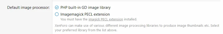

In your ACP change from ImageMagic to GD for image processing.
ACP -> Attachments -> Default Image Processor.
Thanks, just had a look and it's already set to GD.
