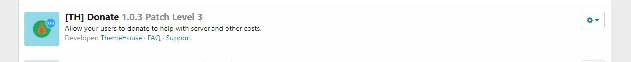

There should be an add-on listed with the badge I mentioned:
That's the one causing the issue. The last action you took with it wasn't completed (you likely got an error message, or perhaps you just closed the browser window?).

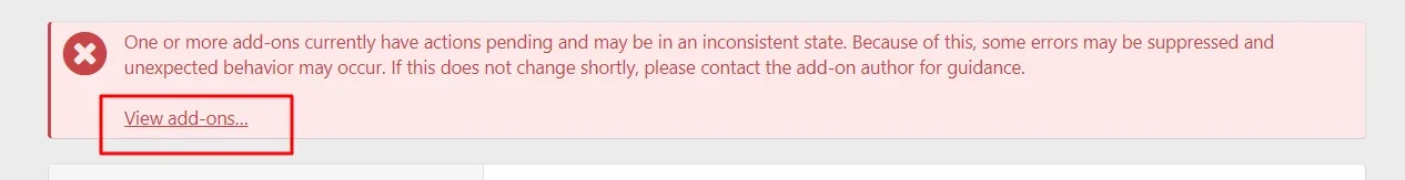

The message appears like this,

Hi Mike, I did that and this appeared,
It seems to be showing a plugin that I deleted, Snog Flags. I couldn't get the add-on to work so I deleted it. Looks like this is still in my database.

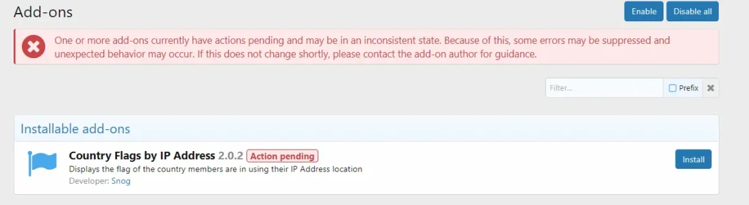

I have just reinstalled it and as you said it shows Pending like you said,
It just won't install, as soon as I click Install it goes back to the error,

At the very least, the add-on developer should at this point help you revert any changes that have been made to the database. There may be some queries it ran on its first attempt(s) which should be removed to prevent issues in the future. Once the database is in a consistent state, it should then be safe to just remove the xf_addon record and delete the files.
Obviously just getting it working would be beneficial, but otherwise the above is required to solve the problem.
