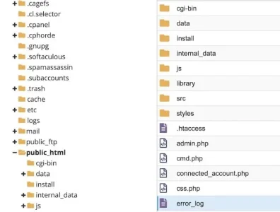

There are no errors in the forum admin panel, but in the external log cPanel error_log
What is this error? Sorry for my english.

No, all the files are present of course, I checked, I even wanted to reinstall the forum today.
By the way, I thought that most likely this is a problem with caching. Thank! Have a nice day!
