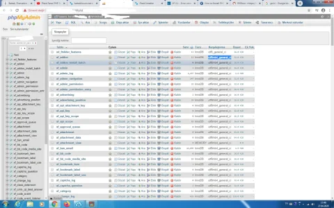

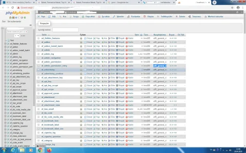

My operations on the server for those with similar problems
Installing PHP 5.6 on CentOS 7
1. To install PHP 5.6, you have to install and enable EPEL and Remi repository to your CentOS 7 system using the commands below.
# yum install https://dl.fedoraproject.org/pub/epel/epel-release-latest-7.noarch.rpm
# yum install http://rpms.remirepo.net/enterprise/remi-release-7.rpm
2. Next, install yum-utils which is an assortment of utilities that integrate with yum to enhance its default features, giving it more advanced package management options and also making it easier to use.
A few of its important features include manipulating repositories, enabling or disabling packages on the go and lots more, without any manual configurations.
# yum install yum-utils
3. One of the most important program provided by yum-utils is yum-config-manager, which you can use to active Remi repository as the default repository for installing various PHP versions. For example, if you want to install PHP 5.5, PHP 5.6 or PHP 7.2 on CentOS 7, just enable it and install as shown.
# yum-config-manager --enable remi-php55   [Install PHP 5.5]
# yum-config-manager --enable remi-php56   [Install PHP 5.6]
# yum-config-manager --enable remi-php72   [Install PHP 7.2]
4. Now that you’ve enabled selected versions of PHP, you can install PHP (here, we have chosen to install PHP 5.6) with all needed modules as follows
# yum install php php-mcrypt php-cli php-gd php-curl php-mysql php-ldap php-zip php-fileinfo
# php -v

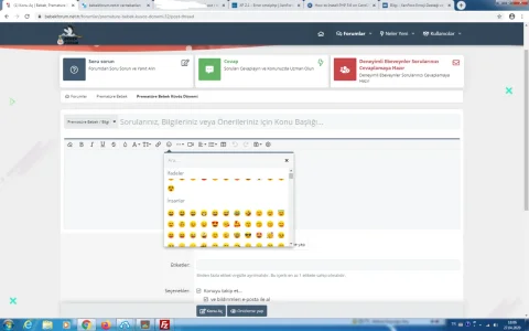

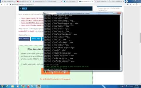

What I did after this update was
 cd /var/www/vhosts/bebekforum.net.tr/httpdocs
php /var/www/vhosts/bebekforum.net.tr/httpdocs/cmd.php xf:convert-utf8mb4
Of course, we don't forget to write the following code to config.php.
$config['fullUnicode'] = true;
