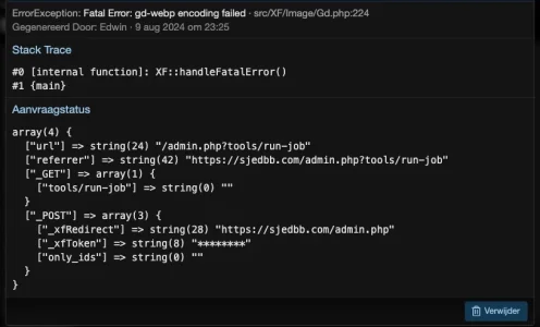

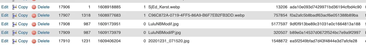

Interesting. When you run the --resume, does it just return immediately with no feedback? There may be an error getting swallowed somewhere if there's nothing in the logs. I did uncover a few weeks ago that imagewebp (used for optimization with GD) can crash PHP in some cases without any opportunity for error handling, which is terrible.
If so, it may be enough to simply mark attachment 17908 (and possibly 17909 as they seem related) as optimized so it gets skipped over. It's likely failing to decode/encode that particular image somehow.
Yeah that'll be it then. There's an open bug report about this, I think we'll have to register a shutdown function to try and mark these as optimized. Marking them as optimized manually should work around this in the meantime.

Thanks, marking those as optimized in the table has allowed the job to continue. Assuming this is specific to GD, and probably wouldn't occur with ImageMagick? Issue here is PHP8.3 on cPanel doesn't compile Imagick correctly.
They've been waiting 8 months so far!
I haven't tested this with Imagick yet so I'm not sure. It may work due to differences in decoding, but they both use libwebp for encoding so it's also possible there's some kind of issue with the source image.
I do have Imagick working on PHP 8.3 (without any trickery, some how).
