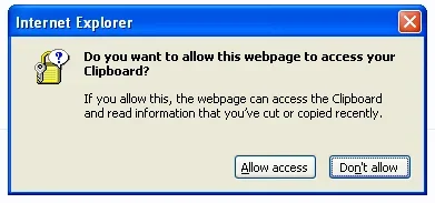

#5
I have a strange problem copying and pasting with IE8, I always get the attached warning message when trying to copy and paste content, and my IE privacy and security settings are currently set to "medium". I can copy and paste the same content over on vbulletin.com, and not get the warning.
Would this be related to this copy and paste problem, or should it be reported as something else.
I'm hesitant to create a new bug report for it just because I don't use IE8 that often, and I assume it was something to do with my security settings, but it doesn't exhibit this behavior on any other site as far as I can tell.
Even if I add xenforo.com to my list of "trusted sites" (and which vbulletin.com isn't), I still get the warning message.
Shamil
#6
This is a security feature.
