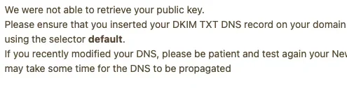

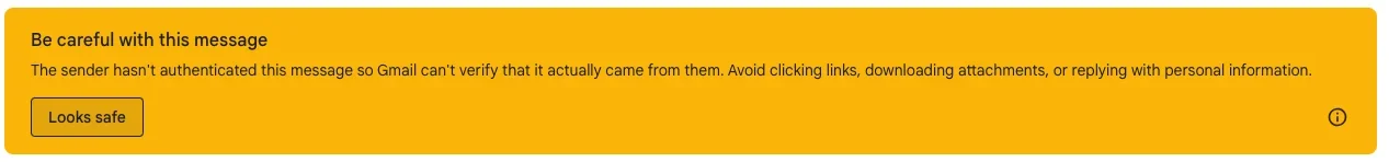

Seems like your SPF/DKIM may not be set correctly in your DNS settings....have you pressed the i to see if it tells you exactly what is off. This is something that I had a recent discussion with another member about... and frequently it's a DKIM/SPF/DMARC issue.
From a couple of sites.. it may be a DKIM issue.

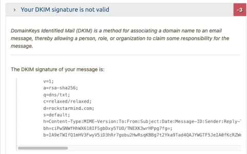

Test it via the ACP using your existing setup at
That should show you any issues.
Thanks for the tip....I've used this service in the past, but unsure how I should test the email address it gives me. Is there a simple way to test outgoing messages from Xenforo? Or do I have to set up a user with the test email address Mail Tester gives me?
