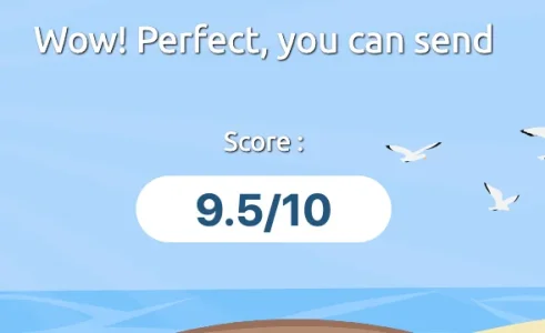

If you aren't sending over 50K a day then you can use Amazon SES and their free tier. It is somewhat of a pain to get configured, but once you do, it works like a charm for sending. My emails are even getting successfully delivered into Hotmail/Live/Outlook inboxes... which when I was hosting my own on a self-rolled mail server they didn't. It would have scored higher, but I haven't set DMARC up yet.
You will still need mail accounts for receiving the bounce/unsubscribe's if you use that feature in XF......I host mine at ZoHo.

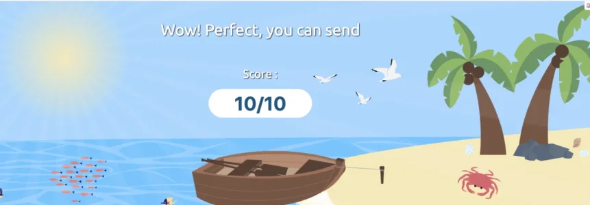

Exactly I have that setup since a decade and it worked 100% every day. Along with DKIM signing and they always have the highest reputation so emails go through any day. Setup an SPF record and youre done.
That was so difficult working on the server ("EXIM") I never want to do that again when I can sent like hundred of thousands of emails from AWS for the price of a coffee.
