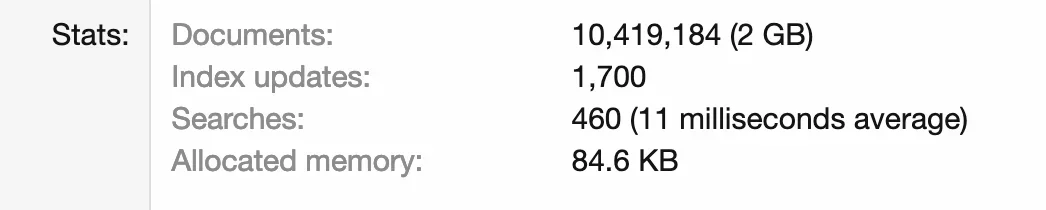

Here are the stats XF is showing:
Does the size here correspond to the amount of memory it needs?
Im Not a Elasticsearch expert. But i guess the 2GB are the heap size of Elasticsearch.
