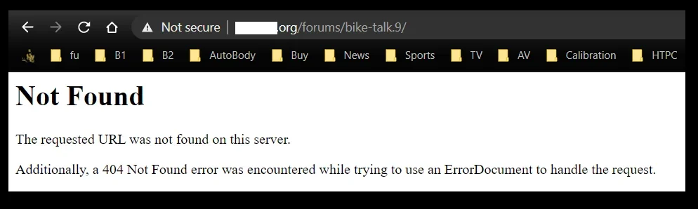

This morning the site suddenly went down for no apparent reason. I had just finished restoring a backup and was about to transfer our IP to it when the original site popped back online as if nothing had happened.
Here is the error we get when we tried to access the webpage or the admin control panel:
Not Found
The requested URL was not found on this server.
Additionally, a 404 Not Found error was encountered while trying to use an ErrorDocument to handle the request.
The logs in the control panel don't show any errors.
Can anyone tell me how to check logs on the CentOS server/MySQL, that might show what happened?

Looks like that is the http (not secure) so you should enable this in acp "Enable board URL canonicalization."
Nope, it's an https board. I imagine it goes non-secure when it no longer exists/gets broken.
And that option is already enabled, I just double-checked.
A 404 is a fundamental webserver error - something happened at the server level to prevent the domain/page being served.
Check the server error log.
If you aren't sure where that is, your host should know.
