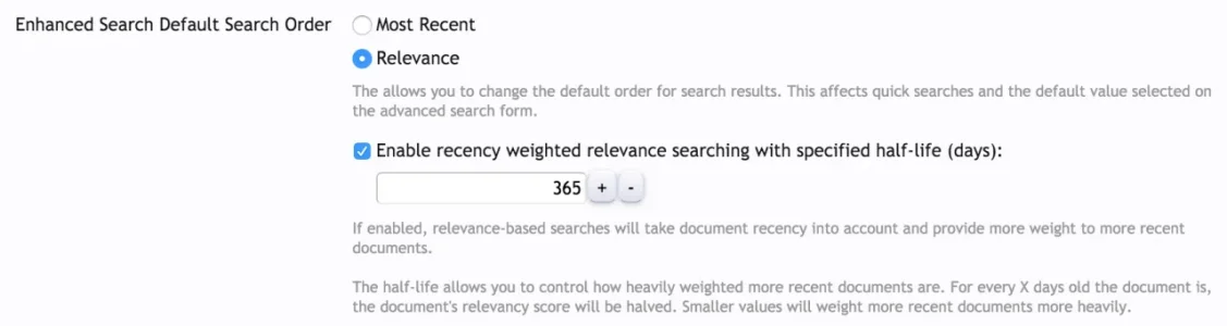

Does that mean we can make certain content types rate higher than others? Or is the weighting limited to just post/thread content types? Possible to see the configuration options in the xenforo ACP?
I was referring to date-based weighting:
There isn't content-type based weighting by default.
