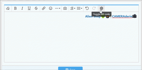

Well, here's a weird one. If you use a BB code then immediately after the closing tag have a single space and then an emoji and then you Toggle BB Code in the editor, the single space is removed. A demo gif is attached.
It does not happen if multiple spaces are used between the BB code closing tag & the emoji and it does not happen with non BB code tags.

@Kevin this has been marked as fixed in the latest version of Froala. Interestingly, our test case still doesn't work :rolleyes: but if I try the exact steps from your GIF then it seems to be working correctly now.
Would you be able to verify?
