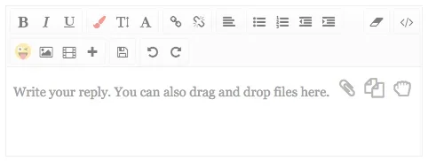

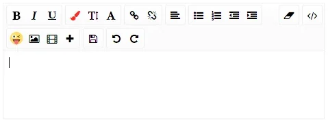

I'm using 1.5.4 and in conversations is not possible drag & drop files IF the redactor box is not active:
not possible:
possible:
I can not reproduce this issue here, I've checked the bug fixes in the new releases but I can not find anything related. probably is something that has been fixed but is not in the list? @XenForoDevelopers

Hello Chris. whoops, you're right Sir. that's the problem. I'm using simply CSS to put those icons there:
.redactor_box .placeholder span:after {
    content: "\00a0""\f0c6""\00a0""\f0c5""\00a0""\f255""\00a0";
    font-family: FontAwesome;
    font-size: 22px;
    color: #B7B7B7;
    line-height: 30px;
Without that custom code it works perfectly again. the weird thing is that the problem is only in conversations.
in threads everything works perfectly. o_O
