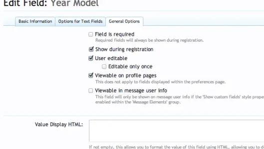

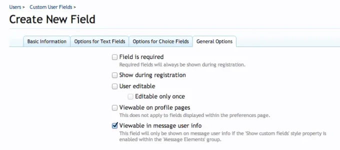

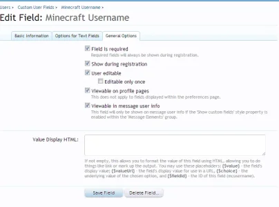

You DID go into the custom user field and tell it to display, correct (Field Viewable in message user info).
Did you inquire with the author of your style "XenFocus"?
Can you get ANY of the additional information to show up (like the # posts, hometown, etc) that are default to be able to use? If these don't show either, then it will be a style issue - and you will need to address that with the style author.
