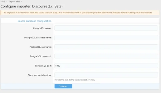

I don't understand how to use the importer... I only found this screenshot, no other documentation.
Discourse runs on a docker container, how can I reach the PostgreSQL server?
Do I need to install Xenforo inside the Discourse container?
Is it possible to have a demo version of the importer so I can see if it works correctly?

It’s just a database and a bunch of files. You could connect to the database directly if configured to accept remote connections. You could mount the disk as an NFS share or similar.
Some of that may be somewhat complex to set up so the easiest thing to do could be to dump the database and copy it to the machine you’re importing to and similarly grab a copy of the files.

Apparently it's not that simple...
I always get the error:
The directory discourse does not contain the expected contents.
Probably the importer wants files inside the discourse app, do I have to copy all the files that are here (./launcher enter app)?

Here's a couple things that I did to get the import to work. My database is 200+GB, so I wanted to connect directly to my production database.
  1. You can get Discourse to create a new database user/password combination for you.
    1. Code:
      sudo vi /var/discourse/templates/postgres.template.yml
    2. Once inside there, add the three lines at the bottom of this snippet (the first three lines will already be there).
    3. Code:
        - exec: su postgres -c 'psql $db_name -c "create user $db_user;"' || true
        - exec: su postgres -c 'psql $db_name -c "grant all privileges on database $db_name to $db_user;"' || true
        - exec: su postgres -c 'psql $db_name -c "alter schema public owner to $db_user;"'
        - exec: su postgres -c 'psql $db_name -c "create user xenforo WITH PASSWORD '"'"'xenforo123'"'"';"' || true
        - exec: su postgres -c 'psql $db_name -c "grant all privileges on database $db_name to xenforo;"' || true
        - exec: su postgres -c 'psql $db_name -c "GRANT ALL ON ALL TABLES IN SCHEMA public TO xenforo;"' || true
  2. You can get Discourse to expose the Postgres database so you can connect to it from outside the container:
    1. Code:
      sudo vi /var/discourse/containers/app.yml
    2. Once inside there, add the last line (the first two lines will already be there).
    3. Code:
        - "80:80"   # http
        - "443:443" # https
        - "127.0.0.1:5433:5432"
    4. This will expose your database on port 5433
    5. You can connect to your database from outside the container using this command
    6. Code:
      psql -h localhost -d discourse -U xenforo -p 5433
Then rebuild your app for the Yaml changes to take effect.
Putting all that together, your migration screen will look like this:
  1. PostgreSQL Server: localhost
  2. PostgreSQL Database Name: discourse
  3. PostgreSQL username: xenforo
  4. PostgreSQL password: xenforo123
  5. PostgreSQL port: 5433
  6. Discourse Files Directory: /var/discourse/shared/standalone

I'm getting this error while importing:
  • ErrorException: [E_WARNING] pg_prepare(): Query failed: ERROR: syntax error at or near "topics" LINE 2: topics.archetype AS topic_archetype, ^
  • src/XF/Db/PostgreSql/Statement.php:35
