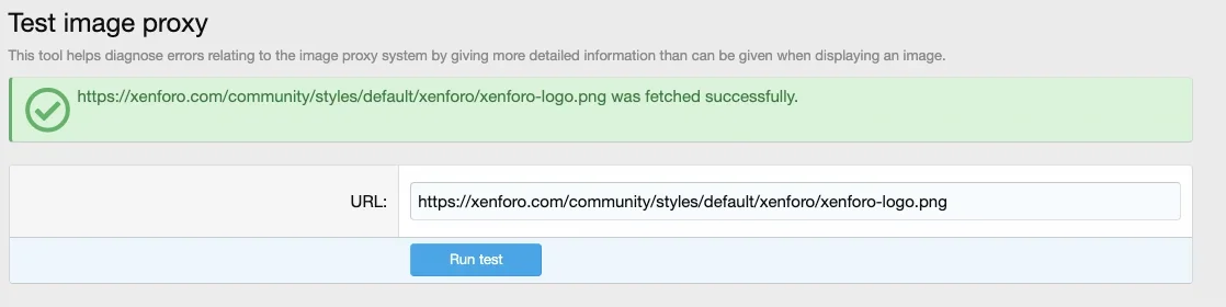

No, it's a single instance of tinyproxy on a VPS. There are no other issues with the proxy fetching any of the images. What specific URL is it supposed to be fetching the file from, so I can at least check the logs?I suspect that’s probably going to be the issue. Google’s servers for serving JavaScript are pretty reliable. Not sure what sort of http proxy setup you are using, but is it setup for failover/retry if it fails for whatever reason?

Honestly I don’t know anything about tinyproxy. The little I Googled says it needs an upstream proxy to function and your logs are implying some issue between tinyproxy and whatever upstream proxy you are relying on?Code:# grep -i googletagmanager tinyproxy.log CONNECT May 23 03:56:56 [12009]: Request (file descriptor 9): CONNECT www.googletagmanager.com:443 HTTP/1.1 INFO May 23 03:56:56 [12009]: No upstream proxy for www.googletagmanager.com CONNECT May 23 03:56:56 [12009]: Established connection to host "www.googletagmanager.com" using file descriptor 10. CONNECT May 23 05:03:52 [12007]: Request (file descriptor 9): CONNECT www.googletagmanager.com:443 HTTP/1.1 INFO May 23 05:03:52 [12007]: No upstream proxy for www.googletagmanager.com CONNECT May 23 05:03:52 [12007]: Established connection to host "www.googletagmanager.com" using file descriptor 10. CONNECT May 23 05:57:10 [23458]: Request (file descriptor 9): CONNECT www.googletagmanager.com:443 HTTP/1.1 INFO May 23 05:57:10 [23458]: No upstream proxy for www.googletagmanager.com CONNECT May 23 05:57:10 [23458]: Established connection to host "www.googletagmanager.com" using file descriptor 10. CONNECT May 23 06:56:18 [13718]: Request (file descriptor 9): CONNECT www.googletagmanager.com:443 HTTP/1.1 INFO May 23 06:56:18 [13718]: No upstream proxy for www.googletagmanager.com CONNECT May 23 06:56:18 [13718]: Established connection to host "www.googletagmanager.com" using file descriptor 10. CONNECT May 23 07:58:47 [23458]: Request (file descriptor 9): CONNECT www.googletagmanager.com:443 HTTP/1.1 INFO May 23 07:58:47 [23458]: No upstream proxy for www.googletagmanager.com CONNECT May 23 07:58:47 [23458]: Established connection to host "www.googletagmanager.com" using file descriptor 10. CONNECT May 23 08:56:55 [12016]: Request (file descriptor 9): CONNECT www.googletagmanager.com:443 HTTP/1.1 INFO May 23 08:56:55 [12016]: No upstream proxy for www.googletagmanager.com CONNECT May 23 08:56:55 [12016]: Established connection to host "www.googletagmanager.com" using file descriptor 10. CONNECT May 23 09:58:26 [23795]: Request (file descriptor 9): CONNECT www.googletagmanager.com:443 HTTP/1.1 INFO May 23 09:58:26 [23795]: No upstream proxy for www.googletagmanager.com CONNECT May 23 09:58:26 [23795]: Established connection to host "www.googletagmanager.com" using file descriptor 10. CONNECT May 23 10:57:16 [12013]: Request (file descriptor 9): CONNECT www.googletagmanager.com:443 HTTP/1.1 INFO May 23 10:57:16 [12013]: No upstream proxy for www.googletagmanager.com CONNECT May 23 10:57:16 [12013]: Established connection to host "www.googletagmanager.com" using file descriptor 10. CONNECT May 23 11:56:41 [12014]: Request (file descriptor 9): CONNECT www.googletagmanager.com:443 HTTP/1.1 INFO May 23 11:56:41 [12014]: No upstream proxy for www.googletagmanager.com CONNECT May 23 11:56:41 [12014]: Established connection to host "www.googletagmanager.com" using file descriptor 10. CONNECT May 23 13:00:24 [12011]: Request (file descriptor 9): CONNECT www.googletagmanager.com:443 HTTP/1.1 INFO May 23 13:00:24 [12011]: No upstream proxy for www.googletagmanager.com CONNECT May 23 13:00:24 [12011]: Established connection to host "www.googletagmanager.com" using file descriptor 10.
There is no upstream configured, the proxy works and has been working since it was introduced for @JoyFreakHonestly I don’t know anything about tinyproxy. The little I Googled says it needs an upstream proxy to function and your logs are implying some issue between tinyproxy and whatever upstream proxy you are relying on?

The timestamps from the logs in tinyproxy suggest it connected to googletagmanagerI suppose it could be setup to suppress writing anything to the error log if it fails to fetch the JavaScript from Google (for whatever reason). Although to be honest, I’d rather know if it was failing than not know.
The problem is that only someone with access to your servers and some familiarity with tinyproxy is going to be able to answer the “why”.
The test doesn’t really tell much because it looks like it’s working most of the time even with the JavaScript fetching. But it’s failing once in awhile.
If it was my setup, I’d want no single point of failure and have proxy redundancy (if tinyproxy is down for any reason, I’d want backup ones it could use).
