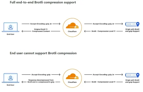

For those using Brotli compression on your server...
Be aware to take advantage of higher end to end compression rates available through Brotli the following Cloudflare proxy features need to be disabled (all option settings are available within this app).
  1. Email Obfuscation
  2. Rocket Loader
  3. Server Side Excludes (SSE)
  4. Mirage
  5. HTML Minification - JavaScript and CSS can be left enabled.
  6. Automatic HTTPS Rewrites
You are going to want to disable the proxy features above within this app to be able to pass through your Brotli compressed content without it being decompressed and recompressed. If one of these proxy features is turned on it will require Cloudflare to decompress the HMTL, apply the Cloudflare proxy feature, and then recompress using Cloudflare’s default Brotli level 4 or Gzip level 8 depending on the user's accept-encoding header.
If you have these proxy features turned off it can pass Brotli 0-11 Compression write through to the end user.

How is Email Obfuscation supposed to be related to Brotli?
Now, I hope there's a way to test and verify this:
That Gzip or Brotli from our origin server is directly passed through to the end user.
Default Brotli compression in Cloudflare is set at 4.
Off the top of my head... I would set your server's Brotli compression 4 and check any compressible mime content to see the returned speed and size through a browser. Then set your server's Brotli compression to 11. Test the same content for speed and size. The speed may not be much different (and there are a lot of factors that can affect this), but the content should be slightly smaller. If any content is smaller, then you know it's your originally server compression on that file, since Cloudflare defaults to a Brotli compression of 4.

I should also mention if any of those same 6 Cloudflare proxy settings listed above, if turned on, will also require the decompression and recompression of any gzip text/html content also.
