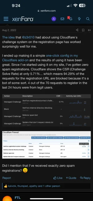

Any idea why I’m not seeing the one click buttons to fight spam registration?
Disregard - It wouldnt show on mobile but does show on my laptop
It should be no different on mobile. I just checked and it shows for me on mobile (the clutter of buttons were consolidated into a "Rules" dropdown since that screenshot, but it shows for me on both mobile and desktop.
