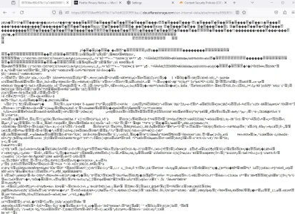

Having a weird issue with firefox showing ascii characters and wondering if anyone else has seen this. This is a fresh install of firefox with no addons turned on. Works fine in google so I know its something specific to FF.
Does it work if you disable presigned URLs? My guess is you uploaded that object outside of the addon (maybe moved it to the bucket with rclone or something) with the wrong content type. If you disable presigned URLs, the content type is set by the application (XenForo) to override whatever it’s set to in the bucket.
And Firefox probably just isn’t as good as other browsers as far as dealing with the wrong content type header.
Just disabled presigned url and it worked. Weird though because this was uploaded to the bucket after the migration. Is there anything you recommend me running on the bucket or changing in r2? I dont want to turn off presigned urls for the security of the expiring link
Well turning off presigned URLs isn’t going to be any less secure than not using it. Security is handled by XenForo user permissions just fine.

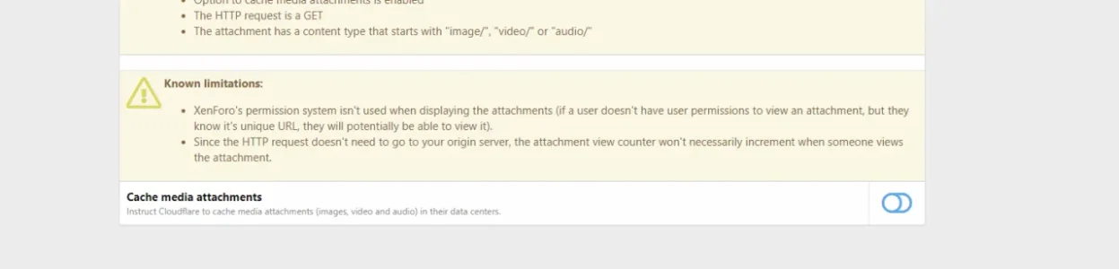

It wouldn’t be cached in Cloudflare unless you specifically instruct it to. Presigned URLs aren’t cached, so if you made a rule to forcibly cache attachment URLs, just remove that and normal XenForo permissions will apply.
Caching attachment URLs and then using presigned URLs ultimately does nothing as far as caching because presigned URLs don’t use the attachment URL.
Basically you can’t edge cache something and use something permission based (XenForo permissions or presigned URLs). Have to pick one or the other.

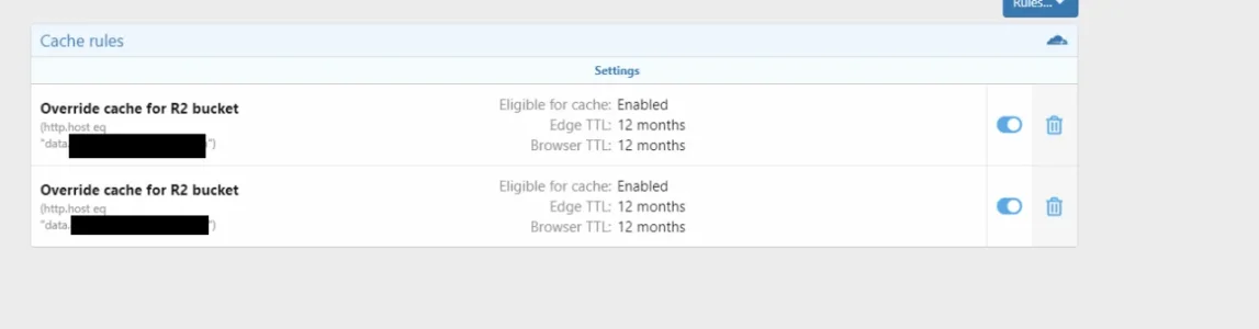

I dont believe I'm caching the attachments. Maybe I misspoke from lack of understanding.
Ya, then just disable presigned URLs and you should be good to go.
Also, if those two cache rules for the public bucket are identical, you can delete one just to keep things clean.

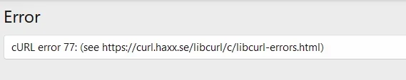

Updated to 1.8.0 yesterday and we've been getting a lot of these errors (usually in pairs) since. Any ideas?
Server error log
    ErrorException: Cloudflare: cURL error 77: (see https://curl.haxx.se/libcurl/c/libcurl-errors.html) src/XF/Error.php:77

I just tried to view the Cloudflare Rules page in the ACP and received another error 77. I did not see an entry for it in the server error log.
