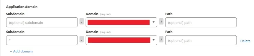

One thing I am wondering:
If I leave the subdomain blank, does that mean it covers the main domain and all subdomains, or do I need to add a wildcard like in this example here?

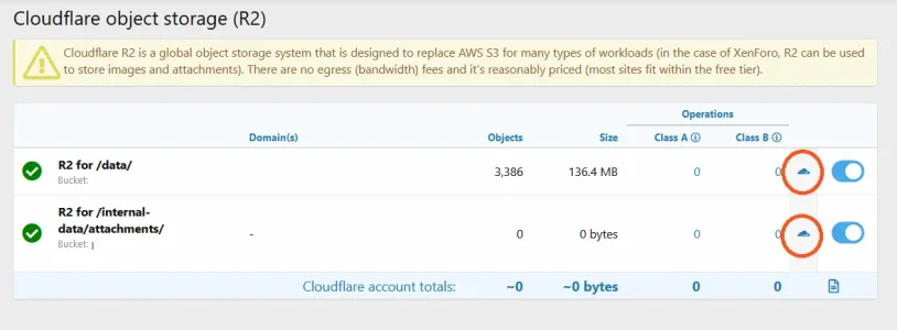

Also not sure if all those 0's for internal data bucket is a bad sign, it shows 1K Class A operations on CF's side. But it looks fine after I re-enabled the bucket in the future (see below).

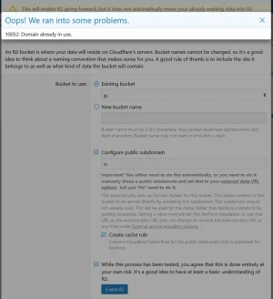

After I fixed my problem I tried to rebuild the addon but it didnt fix so I had to uninstall the addon then install it again. (What a great opportunity to remake the API Key : ) ) And now when Im in R2, I can't automatically configure because the subdomain exists already. Maybe it can just prompt to delete and recreate in this page. Thats what I ended up doing so that it can just do its thing.
Also, I had a problem in my XF code_cache that made all the phrases not finish compiling.
Can't really fix that with anything on this end. The phrase and template rebuilding phase of addon installation is done by XenForo core. So if it failed for whatever reason, it's still XenForo core that needs to actually do it one way or another. Why it failed might be worrisome if it's happening to you a lot, but whatever that reason is is outside the scope of any addon itself. Maybe the addon didn't get fully installed somehow and was missing the phrase xml file... but then why would some phrases be there and not others? Not really sure.
Well, it does say, "This subdomain should not already exist."... So if it's an existing bucket that already has the subdomain attached that you want attached to it, you don't need to tell it to configure the public subdomain (uncheck the box to do it since it's already done). But even then if you do do it, it won't break anything, it will just let you know the domain was already in use when it tried to create that subdomain (it won't try to undo everything else... so it should still all work fine if you ignore the message).
As far as trying to handle a subdomain already in use error in a different way, I'm not really sure you would want to. What if you tried to assign a subdomain that was simply in use by some other part of your site... would you really want us to go in and delete that DNS entry that was already there and replace it?
In my opinion, doing what it does (telling you it needs to not already be in use, letting you know if it was already in use, but still doing all the other parts and not halting the process if it was in use) is probably still the best approach. Then you can decide what to do about it (if anything) rather than rely on a one-size fits all action to take if it was in use. Like what if you put the root of your domain in there and simply forgot the subdomain... it wouldn't seem like a great idea to mess with your DNS, delete the apex record for your domain for the normal site and replace it with the URL of an R2 bucket.

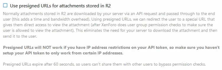

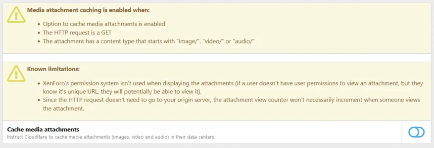

@digitalpoint I know there was an issue with caching s3 files on cloudflare because it gives access without obeying the forum permissions. Is that the same scenario with R2 when its cached or will it follow xenforo permissions?
Same problem. Take a look at these two options in digital point's addon:
and
So, you should disable cache media attachments but enable pre-signed URLs for optimal forum performance.
