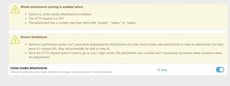

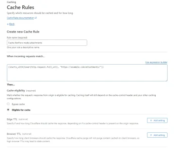

Question about caching attachment.
I enabled this option:
In Cloudflare, it created this rule:
(starts_with(lower(http.request.full_uri), "https://example.com/attachments/"))
...but with out forcing Edge/Browser TTL:
Xenforo adds the no-cache header, so I wonder if this was intended?
Is the no-cache header there when you able the option from the addon? It's supposed to change some headers when you enable the option (specifically it changes the Expires and Cache-Control headers). It intentionally does not force the edge caching in the cache rule, rather just make it eligible (able to be cached). Not doing a blanket "cache everything" gives us more control (for example only cache "media" based on the content type).
You can see the logic used in the DigitalPoint\Cloudflare\Listener\AppPubComplete.php file.
Ok thanks for explaining. All seems fine.
The no-cache was in the request header. The response header is looking good.
Cf-Cache-Status: HIT

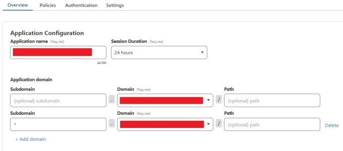

Thanks! The applications set up by your addon helped me figure it out. Any particular reason to have separate applications for install and admin.php? Is there a downside to putting both domains under a single application?
No reason other than Zero Trust applications are defined by the URL. So you can't have a single application because the URLs are different for admin and install. If you could... ya, it would make sense to make them a single "application".
There also might be cases where you want all admins to be able to access the normal admin area, but only certain admins to access the install URL.
In my playing around, it seems you are able to add up to five "domains" per application.
I found this when setting up an application for my test sites. I'd click "Add domain" to include each of my test site subdomains, but then I learned you can use wildcards.
So I think you could include both URLs as different "domains" in the same "application". Of course the use of the word "domain" here is a bit confusing.
True.
True.
Ya you definitely can. The addon just does it as two different because of the reasons I said… allows you to differentiate between “normal” admins and specific admins that can do installs.
