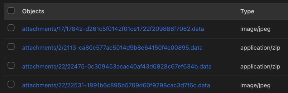

Strike that, it's not area specific. I went back to old posts with various attachments and see the issue there. Who really controls the content type, the requester or the host? For example, if you're going to request a file that ends in .PDF, shouldn't the caller by specifying the content type? If you know the extension of what you're calling can't you specify the content type? Thinking out loud....how can we resolve this?
Objects in R2 appear to have the correct content types. However, I believe something gets stored in XF with .data extensions and therefore R2 uses the application/octet-stream on those. Something must be wrong with the presigned URL code I'm guessing that's not decoding this properly? How can XF download the item ending in .data properly (content type) with presigned off if it's the same object from R2? My guess is XF knows the content type and is requesting it accordingly? Again...thinking out loud...
If you are doing attachments "normally", the content type is set by XenForo.
Presigned URLs set the content type based on the content type that is set for the R2 object. You most DEFINITELY would not want to try and set a content type based on object key (what can look like a path/file name). All attachments are stored with a key ending in .data, but with a correct content type:
File extensions are never looked at for determining content type (it would be all sorts of problems if it worked that way). For example XernForo avatars universally have a jpg extension even if they are other formats. For example, look at the content types here:
Cloudflare will always determine the content type based on the content of the object when it's uploaded, EXCEPT for a case where you upload something with a specific content type set by the uploader (at that point, Cloudflare will treat it as the content type you are telling it to be, not the one Cloudflare thinks it is).
So in your case, it just sounds like you somehow uploaded existing content in some way where it was trying to be smarter than Cloudflare and instructing Cloudflare to treat it as a certain content type vs. what it actually is. The "right" thing to do would be to fix that (download them and just re-upload them to R2 without telling Cloudflare to force a certain content type). The right thing to do is not to try and build a bunch of one-offs and start carving out sub-directories or XenForo content types that presigned URLs do or don't work with. You are talking about massive added complexity and maintenance as it would surely cause other issues, when the correct thing to do is simply fix the issue of incorrect content types set by whatever you used to upload. Option B is simply to not use presigned URLs, then you aren't relying on the incorrect content type you have set on the R2 side.
TL;DR: you should never, EVER force set content type based on file extension with XenForo files. Even avatars have a .jpg extension 100% of the time if they are PNG files.
Thank you. I used that tool, discussed on this site or in your add-on description (can't remember) that mass uploads the files to R2. I don't recall an option to pass a content type and I guess the .data being generic R2 just put application/octet-stream on those. Not sure exactly how to fix but I'm not sure presigned URL's offer me that much savings to warrant this effort? I don't know... The question remains, how can this work when presigned URL's are OFF and the issue is only affected when ON?

I don't use rclone myself, but I vaguely recall seeing somewhere it uses the mime-type definitions for the system you are running rclone on. The better thing to do is just not set the content type though (which is why things work better that were uploaded by the addon... new stuff).
Because XenForo sets the content-type as part of the request for the attachment. Presigned URLs bypass all that, you are redirecting users to the presigned URL which sets content type based on the content type set for the object in R2.
I believe that by default, rclone will attempt to override content type/mime type if the machine (server) running it has system-wide mime types for certain extensions. On Linux, that would be in the /etc/mime.types file. ".data" isn't a normal mime-type in there (I just checked my servers and it's not in there with a fairly vanilla/default file) , so I suspect someone on @NealC's server set .data to some specific mime type there, and then rclone decided to adopt that since that's what someone set it to system-wide.
So I can see how it would work fine for most people, but since rclone looks at system settings, there might be cases where it's trying to do something different on a certain server. Either way, the mime-type/content type being overridden is really only an issue when using presigned URLs (since there isn't an opportunity for XenForo to explicitly set it).

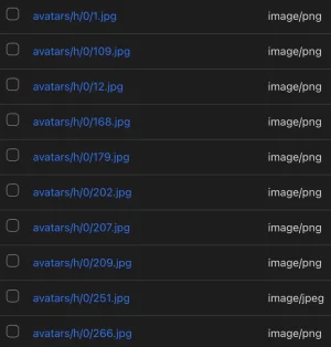

As an example look at the avatars stored in R2 in this post, all the object keys end with .jpg, but Cloudflare correctly assigned the right content type because it only looks at the actual content (not the key). XenForo saves all avatars with .jpg extension even if they are PNG (or other formats), so it's a good demo of Cloudflare only looking at the content (and never the key/"filename").
The issue here is something (I assume rclone based on what you said) decided to try and be smarter than it needed to be and explicitly assign content types based on file extension (big no-no for XenForo stuff). If you uploaded avatars with rclone, I suspect they all got assigned image/jpeg content types even if some are PNG or GIF. The good news for that is it's fairly common for images to get assigned the wrong extension on websites, so I suspect that for images, browsers will treat the image as the content it is rather than what it's told by the web server.

If that were the case, wouldn't PNG images with .jpg extensions then be assigned an image/jpg mime type?
