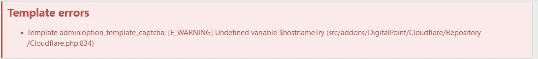

Hi, we are currently testing this addon and we noted that we're getting some intermittent gateway timeout errors when attempting to load certain things such as the addon options and the R2 options in the ACP. Has anyone else experienced the same?
We also get this error when we attempt to access the Access or DMARC management links in the Cloudflare setup options:
ErrorException: [E_WARNING] Undefined variable $hostnameTry in src/addons/DigitalPoint/Cloudflare/Repository/Cloudflare.php at line 834
    XF::handlePhpError() in src/addons/DigitalPoint/Cloudflare/Repository/Cloudflare.php at line 834
    DigitalPoint\Cloudflare\Repository\CloudflareAbstract->getZoneId() in src/addons/DigitalPoint/Cloudflare/Repository/Cloudflare.php at line 851
    DigitalPoint\Cloudflare\Repository\CloudflareAbstract->getAccountId() in src/addons/DigitalPoint/Cloudflare/Repository/Cloudflare.php at line 1444
    DigitalPoint\Cloudflare\Repository\CloudflareAbstract->getAccessApps() in src/addons/DigitalPoint/Cloudflare/Admin/Controller/Cloudflare.php at line 729
    DigitalPoint\Cloudflare\Admin\Controller\Cloudflare->actionAccess() in src/XF/Mvc/Dispatcher.php at line 352
    XF\Mvc\Dispatcher->dispatchClass() in src/XF/Mvc/Dispatcher.php at line 259
    XF\Mvc\Dispatcher->dispatchFromMatch() in src/XF/Mvc/Dispatcher.php at line 115
    XF\Mvc\Dispatcher->dispatchLoop() in src/XF/Mvc/Dispatcher.php at line 57
    XF\Mvc\Dispatcher->run() in src/XF/App.php at line 2483
    XF\App->run() in src/XF.php at line 524
Looking at the PHP code it appears this variable is supposed to be populated within the getZoneID function. I'm not the best at reading PHP code but it looks like it's doing something with the hostname variable, which is set to null by default. It looks like this value is supposed to be populated from a getSiteUrl() function that pulls the board URL directly from Xenforo using XF::options()->boardUrl, but I can't really tell where it goes from there to cause an error. As far as I can tell the ACP board URL is set accurately and there is a DNS entry for the subdomain we're hosting the test site on in the cloudflare dashboard.
Can you post a screenshot of the board URL setting as you have it set? One thing I can think of off the top of my head would be if the URL is not a valid URL somehow (like if you had something in that setting, but it's technically not a URL).
More specifically, the hostname is extracted from the URL with PHP's parse_url() function.
On seriously malformed URLs, parse_url() may return false.
I will send you a message with the board URL setting, but I do not want to share the test site publicly even though it is closed for viewing. The setting matches the "suggested URL" that XF recommends.
Maybe try deleting the board URL setting, save it and manually retype it in? The URL looks okay, but maybe there is some stray invalid/invisible characters in there? I set up a test scenario on my end and it was able to handle that URL just fine (however, I typed it in, not copy/pasted what you have) since it was a screenshot.
Just got the normal/expected error (since that zone isn't on my Cloudflare account) of:
Cloudflare zone not found: subdomain.yourdomain.com
Same issue even when retyping it out. Also getting the same error on a template too when loading the board basic options:
EDIT: I tried a php script to run a var_dump on what parse_url returns from the PHP_HOST_URL and it returned the subdoman.domain.com as a string, as expected. Plugged the result into the PHP code directly for the $hostname variable definition on line 785 and it works when hardcoded. So definitely something going on.
Ya, hard to say exactly what's going on without being able to replicate it. What version of PHP are you using? Maybe can try replicating it with whatever version you are using. Although to be honest, I feel like if there was some issue with a certain version of PHP, someone would have run across it by now. But worth checking out...
The current version of PHP used on the forum is 8.1.13, specifically using php8.1-fpm and not standard php. I just tried rolling it back to 8.0.28 and 7.4.33 with the same result. I don't think it's with the PHP version.
