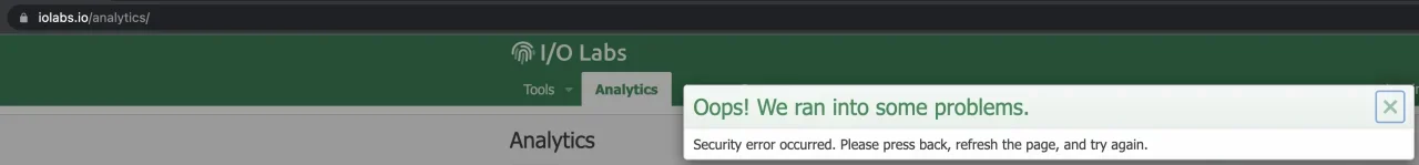

I don't know if you changed anything but I was able to log out and then log back in once but now the error appears again if I try again.
Just register to your site I/O labs, i can't log out.
I had the same message as @Kirby the user has changed...
And now if i click on my username i have this error and the menu doesn't open.
I can reproduce this bug .. because the cached response has response header Last-Modified with older value which makes the browser display the locally cached version of the page ( newer ) and send 304 response .. same buggy behaviour happens with xenforo guest cache and reported here https://xenforo.com/community/threads/logout-bug-when-guest-caching-is-enabled.200977/.. but I couldn't reproduce the bug descirbed by @Kirby

This error was most likely caused by guest caching.
Ya, that was something not in the addon itself, rather some JavaScript specific to the site. It should already been fixed (if you do a hard refresh, you should get the version where it's fixed).

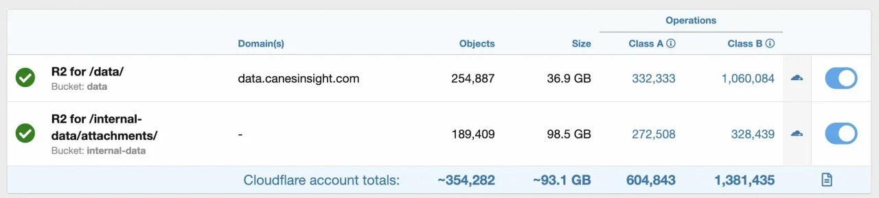

I had a few minutes to check (busy few days w/ a funeral)--I now have /data/xfmg and /internal_data/xfmg .
I can see where /data/xfmg would be included in the R2 bucket, but how do I add another for /internal-data/xfmg?
