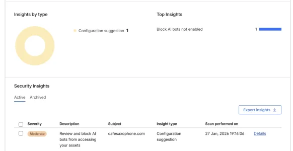

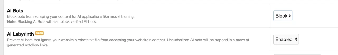

I'm a little confused by one thing
In settings I (think) I have blocked AI botsScreenshot 2026-01-28 at 17.57.13.webp
However in the CF domain list, I see security insights moderate severity Block AI bots not enabled so does that mean the addon is not communicating with Cloudflare?

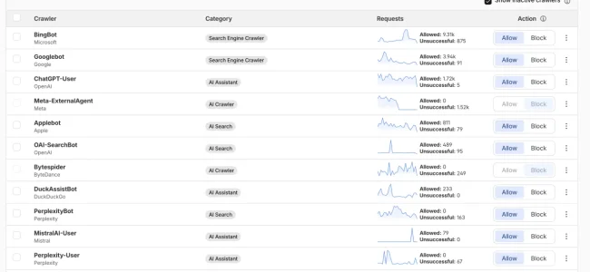

Bit then on AI Crawlo Control I see they are blocked.
Can anyone explain this, thanks.
In settings I (think) I have blocked AI botsView attachment 333146
The addon doesn't do anything with "insights". Check the underlying setting. That's all it does there (toggle the setting).

Mine does this as well, and I am not using the Cloudflare add-on, so I know it's not related to @digitalpoint add-on. It's odd, it's almost like Cloudflare is missing a toggle. Either that or it's a bug because I have everything enabled as well, and I get the same message.
Does anyone know if this is something that can be ignored or does it need something doing about it?
Says in your screenshot it's a "configuration suggestion". Whatever you want to do (or not do) with that info is up to you really. If you want to block more AI bots, block them. If you don't, then don't. 🤷🏻‍♂️

Yes I want to block all ai bots, hence I have ai bots blocked. The setting here implies all ai bots as there is no choice
screenshot-2026-01-28-at-17-57-13-webp.333146
Or am I misunderstanding this?
Would need to ask Cloudflare that. The settings presented in this addon are simply coming from Cloudflare's dashboard. If the setting isn't toggling in Cloudflare's dashboard when you toggle it in XenForo, I could help with. But backend tech info about about what Cloudflare is doing with their own settings, that's more of a Cloudflare question.
