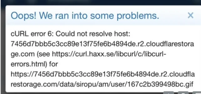

@digitalpoint when I try to edit a banner ad from Siropu Ads Manager I get the following error:
Siropu confirmed he is using the copyFileToAbstractedPath method to store the attachments. Could that be the reason why I get this R2 error?
