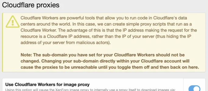

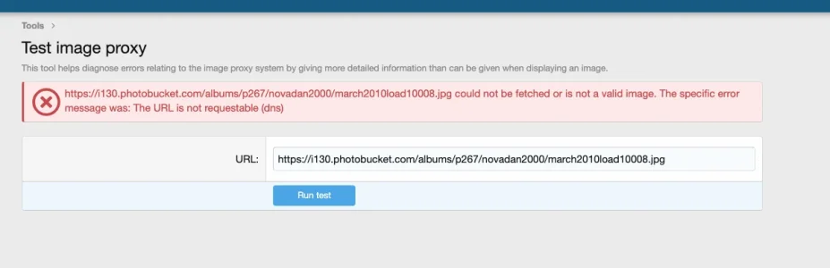

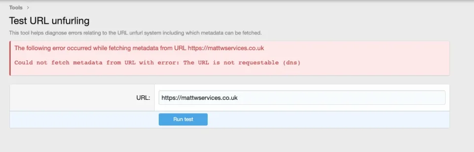

Just noticed that on my sites with this addon installed, it's breaking the image proxy and unfurl function:
This is running on multiple different servers and stacks (CentOS7.9 / Rocky8.7), DirectAdmin, cPanel, Centminmod, Litespeed and nginx.
I've done a packet capture with this addon disabled using the image proxy:
With the addon enabled, it's not even making it to the network layer:
# tcpdump -vvv -i eth0 host 51.89.152.65 -n -s 0 -w /root/image.cap
dropped privs to tcpdump
tcpdump: listening on eth0, link-type EN10MB (Ethernet), capture size 262144 bytes
Got 0
Managed to track it down to having the workers enabled for the image and unfurl.
This might have actually been caused by re-naming the subdomain used for the workers.dev URL. I've disabled and re-enabled them on one of the sites, and it's working now.
Yep, that’s exactly what it would be. The subdomain for your Workers is very important and it reads what it is when you enable the proxy features that use it. So yes, changing your subdomain will cause DNS issue on the backend when the one it knows about becomes unresolvable.

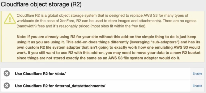

I wonder if R2 can now be used without modifying the code provided by XenForo developers 🥺
For those already using R2, how exactly are you using it? I assume an S3 compatible abstracted filesystem adapter? And just across the board (all of data and internal-data, each with it's own bucket)?
I've started to put together an automatic configuration system (it's very, very early... definitely not ready at this point) for a future version of this add-on, so I figured now is a good time to get input from people.
First of all, I've come up with a way so each folder inside filesystem prefixes can be on their own adapter. What this means is if you wanted to have internal_data/attachments in R2, internal_data/keys in XenForo data registry (a custom filesystem adapter I made) and everything else in internal_data just in the local file system (things like sitemaps, file_check, etc), you can do that.
...from within XenForo admin, you can create a new bucket (or use an existing one), you can automatically configure a public subdomain (for direct access for /data/ as an example).

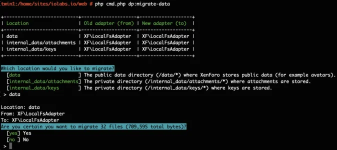

I've started building a data-migration cli tool to move data between different abstracted filesystems (for example you could go from a local adapter to R2):
It's a multi-threaded system (defaults to 10 parallel threads, but can be increased if a server has the resources). I haven't made the R2 adapter yet so that's why it doesn't actually show there yet.
Right now the major holdup is Cloudflare has 3 APIs for object management (a Workers based one [which sucks because then there's a per request cost if you do more than 100,000 per day], the S3 emulation API [which I hate because now there's more keys and hashes and other crap to deal with], there's an undocumented REST API, which is what Cloudflare's dashboard uses... I have that working, but it seems they have severe rate limiting on it, so you run into issues real quick if you are trying to move a ton of objects you already have to R2 at once).
I'm storing both data / internal_data in the same bucket. I'd not split them out into their own. Each site I'm using it for has their own bucket.
I'm also using the cache API worker in front of it:
So the R2 bucket URL is mapped to the worker.
Well data and internal_data aren’t guaranteed to have unique paths within them. So I could see that being problematic if using the same bucket.
Also, data is intended for public access and internal_data is not (if you are using a Worker for just data I suppose you could work around that). But you don’t need a Worker to allow things to be cached if it’s strictly for that (you can simple use the domain access setting and if you don’t like the default cache control [I believe it’s 6 hours by defaulf], you can use a page rule or cache rule to make it whatever you want). You also don’t incur a per request cost for doing more than 100,000 Worker requests per day.
To me it makes more sense to isolate data and internal_data since the permissions are intended to be different and (in theory) you could have path/file and collisions.

anyways. for r2... i am using the addon xenforo has provided with changes to core code provided here:

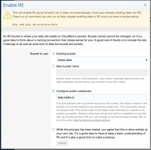

Have the R2 functionality live on iolabs.io. Made my own filesystem adapter that's more efficient than one of the ones that are made for S3.

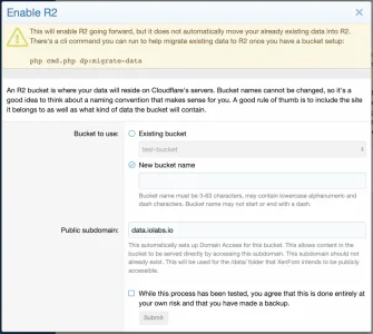

Since the add-on has an API access token for other things, I've been able to make it really easy for users. You click a button and it asks you for the bucket name you want to use. It will automatically create that bucket, configure public domain access (for "data") and voila! Everything is configured automatically without you needing to muck with S3 authentication or do any config.php editing.
There's also a cli command I built that will migrate data between two adapters (in this case it was the local file system adapter and R2). So everything was moved cleanly automatically.
Going to let it run a bit on iolabs.io to make sure nothing unforeseen comes up, but that's where it's at now.

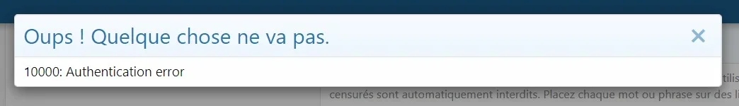

Get this error when i click the Setup in Cloudflare button for Turnstile.
  • ErrorException: 10000: Authentication error
  • src/XF/Error.php:77

BTW Turnstile work fine... but i can't see Analytics and Settings buttons
Thanks for your help ! :)
