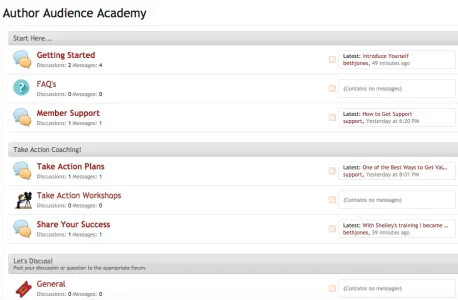

Arty
Add !important to rule to prevent it from being overwritten:
.nodeList .node.node_25 .nodeIcon
background-image: url('http://www.shelleyhitz.com/access/wp-content/uploads/2015/05/take-action-workshops.png') !important;
background-position: 0 0 !important;
Also your icon is not a proper node sprite, it doesn't have unread image. Therefore I've reset background-position in code above.
