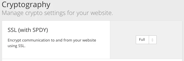

Even better (and more secure) would be to use at least a self-signed SSL certificate on your server and set CloudFlare's SSL settings to Full (or Strict if you have a valid SSL cert from a signing authority).
Using CloudFlare's "Flexible" SSL setting does not encrypt traffic between your server and CloudFlare.
Full SSL (strict): Encrypts the connection between your site visitors and CloudFlare, and from CloudFlare to your server.
Full SSL:
Encrypts the connection between your site visitors and CloudFlare, and from CloudFlare to your server. The difference between Full and Full (Strict) is that Full (Strict) checks for a valid certificate on your origin server, whereas Full checks for any certificate.
Flexible SSL:
There is an encrypted connection between your site visitors and CloudFlare, but not from CloudFlare to your server.
Tricking your server into thinking it's using HTTPS via config file is possible, but I'd still recommend actually *using* SSL if possible (simply for security's sake).
