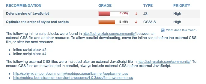

Will this help defer parsing of javscript seen here when testing of my site being poor in this area?
Yup, as much as possible. Depends on the site but you can generally expect modest improvements.
