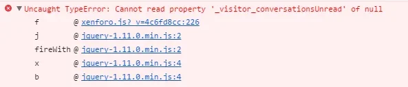

When i'm connected on mobile hot spot and mobile is connected thru 3G. This problem doesn't occurs when connected by cable. Any solutions?
I can't reproduce when throttling my connection to 3G speeds. Is this issue persistent? If so, could I have a URL to your site? You can send it in a conversation if you like.
Your ISP/gateway might be doing something weird to the response. Can you dump the response and look at it? It should be JSON, but if upstream from your device is mangling the response who knows what it could look like.
Yeah, now that I think about it, that's the most likely culprit. That's not the JS itself causing the error, but rather XF trying to parse a JSON response to check for unread alerts/conversations. It looks like the response is malformed.

Hello! Sorry for late response.
The error occurs when i'm trying to submit a thread edit. I can't edit my threads when i'm using 3G.
