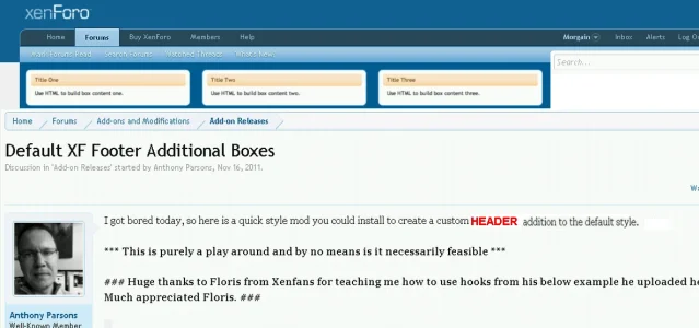

I got bored today, so here is a quick style mod you could install to create a custom footer addition to the default style.
*** This is purely a play around and by no means is it necessarily feasible ***
### Huge thanks to Floris from Xenfans for teaching me how to use hooks from his below example he uploaded here. Much appreciated Floris. ###

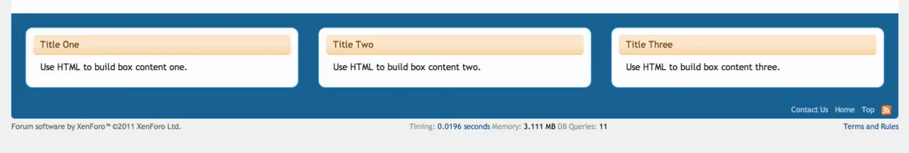

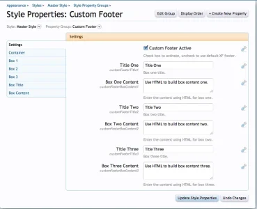

It will create two templates and a property style menu. It does not affect the default XF footer in any other way.
I have shifted the default XF colors, etc, out of the @property attributes to minimise issues with colouring, though you could put them back within them in the footer_custom.css template and control them uniquely from the new style property tab created.

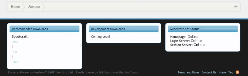

Anyone know why the the boxes would only be allowing a single word per line when I'm entering HTML and such in them? I got box 3 to work fine, but boxes 1 and 2 are apparently not liking the content I put in them or something. When looking at the HTML source and CSS, I see no reason why it would be doing that.
Care to post the HTML and CSS you're using? The boxes don't just distort... if you don't close a tag / nest them correctly, you may be creating a problem. The boxes already use XF default baseHtml class to correctly render HTML.
The boxes are ordered, Box 3 (floats right), then Box 1 (floats left) and Box 2 does nothing, as it will automatically fall between them both due to floats and widths.
The reason its done that way is to ensure the left and right boxes correctly reside on their respective margins, the center box centers automatically.

This is all I am using right now.
HTML:
<b>Spoutcraft</b>: <a href="http://spout.in/exe">exe</a> | <a href="http://spout.in/jar">jar</a> | <a href="http://spout.in/app">app</a>
Ok... that is interesting. I see your problem when doing it myself, and your syntax is correct. Leave it with it... as I have to update my localhost to the latest version to ensure its not an beta / RC issue, and also what has changed in the 1.1 version to force that onto each line.

I'm using 1.1.0 final right now and the modified version that Floris released, although your original one did the same too.
Ok, problem fixed. Upgrade uploaded above.
The problem was that the boxes were inheriting the default footer link css, which turns footer links into blocks, which means a line before and after is placed automatically. I changed that to display: inline for these boxes, and remove default padding that was also inheriting.
Should be good now.
You will see the amendment within the footer_custom.css file:
Should be good now.
