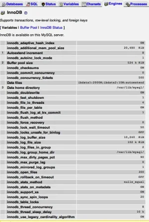

#6
Well, this is what it looks like on the MySQL server:
It clearly states that the server has support for InnoDB. Why it's not used during the installation of xenForo is still a mystery for me. I'm trying to troubleshoot this with my web host.

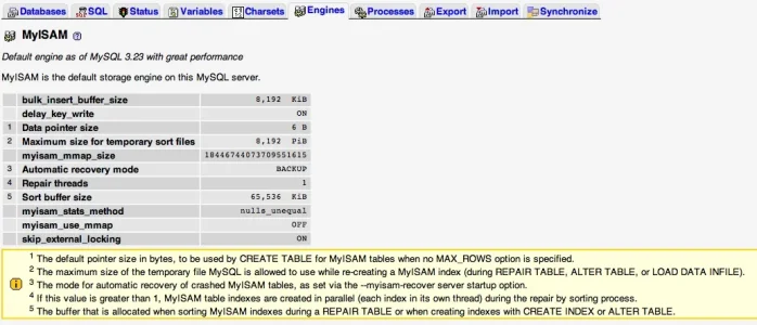

#9
In phpMyAdmin, when I clicked on MyISAM under storage engine, I saw this:
Does this mean even though there is support for InnoDB MyISAM will be used during installation of xenForo since it turns out this storage engine is default on the mysql server?

#10
TBH it looks like your InnoDB engine is running - but to check, go to the home page of phpMyAdmin and click the link for "Storage Engines". Is InnoDB linked and can you click the link? If so it's configured and running.
What about user privs for the MySQL user you are using when installing XF? Does this user have ALL privs?
#11
InnoDB is linked and when I click on it, it takes me to one of the screenshots above where it says it's functioning properly.
My host is using a special web front when creating new database instances. No where I can set what kind of DB it should be.

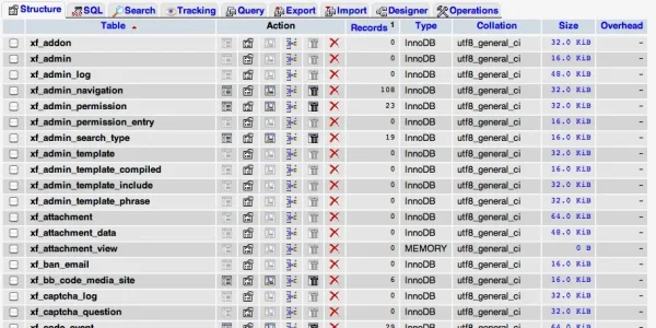

#14
I decided to do a complete reinstall of version 1.1.3. All of a sudden it seems like the storage engine issue is sorted out. How, I don't really know. But know it looks like it should in phpMyAdmin (y)
