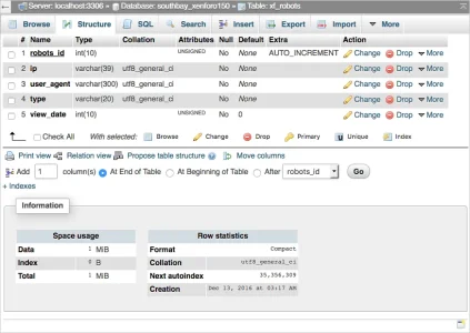

Here's the structure of the xf_robots table:

This happens if the string isn't valid UTF-8. If you're just pulling the user agent from the HTTP_USER_AGENT value, there's no guarantee of its encoding and I have no idea if there's a spec that says what encoding it should use.
I don't think I've directly used it, but I believe you may need to run the value through utf8_bad_replace() to remove invalid characters and then XenForo_Input::cleanString() to remove control characters/make it MySQL safe.
