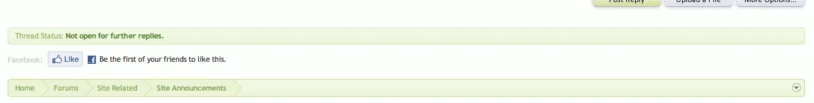

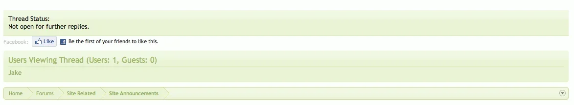

I need to report another bug that actually makes me want to disable the feature. When the addon is active, it makes the locked thread notice appear much differently and not at all pleasant. Could this be fixed in a later release?
Addon Disabled:
Addon Enabled:
