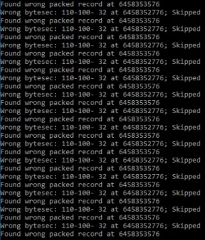

So, I expanded my server disk drive to 4 TB, the repair process still going on (it's been overnight now), now the xf_post.TMD size is 700 GB (it's still creeping up and doesn't make sense to me)
Command used: myisamchk --silent --force --update-state xf_post.MYI, and here's the output:

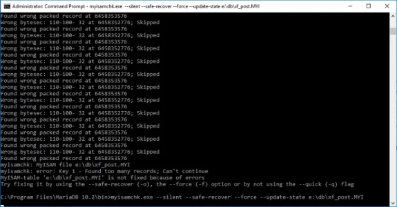

Update: After consumed like 1.5 TB it failed and came with a recommendation, i.e. to use --safe-recover option:
Now it's repairing again, I'll keep updated here.

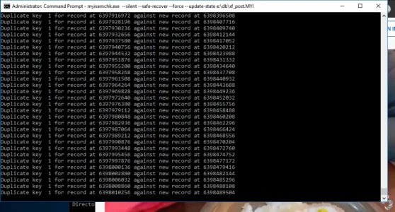

Update: Now it floods me with heaps of Duplicate key 1 for record at X against new record at X:
