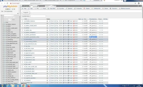

I realized that PHP version is old and this command cannot be executed in this version. I tried many times, even for days.Finally, I wanted to research PHP upgrade issues. I searched and found. Previous Database :
![344E4A9B-64F4-4594-ADFC-D68DF4CAF847.webp 344E4A9B-64F4-4594-ADFC-D68DF4CAF847.webp](https://xenforo.com/community/data/attachments/271/271897-5a2b7db9f14d69418290136170d1cbf6.jpg?hash=Wit9ufFNaU)

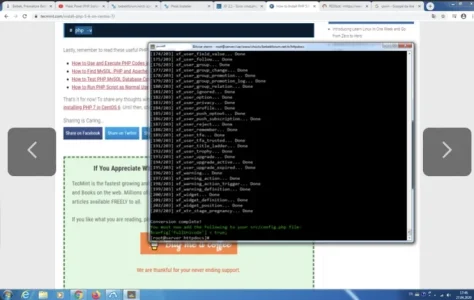

Now I go to the directory where the baby forum is.
and I am executing the command given by my brother XDinc.
Result;

Code:[root@server ~]# cd /var/www/vhosts/bebekforum.net.tr/httpdocs/ [root@server httpdocs]# php /var/www/vhosts/bebekforum.net.tr/httpdocs/cmd.php xf:convert-utf8mb4
I applied this command and the command given by our brother XDinc. You just need to find the exact directory where your site is located. The error message the server gave me;
PHP 5.6.0 or newer is required. 5.4.16 does not meet this requirement. Please ask your host to upgrade PHP.
Of course, as my XDinc brother said, we do not forget to write the following code in config.php..php /var/www/vhosts/bebekforum.net.tr/httpdocs/cmd.php xf:convert-utf8mb4
$config['fullUnicode'] = true;

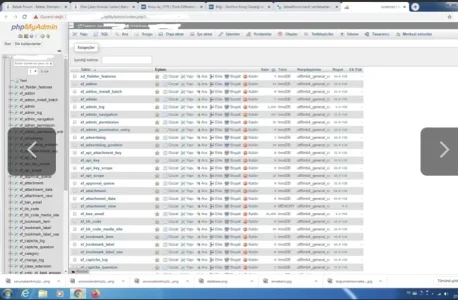

Result;
![871F7311-8522-4FA7-ADA4-82ADD79359A0.webp 871F7311-8522-4FA7-ADA4-82ADD79359A0.webp](https://xenforo.com/community/data/attachments/271/271898-5e1d654ab6736094ba6baf98a6ec2096.jpg?hash=Xh1lSrZzYJ)
![F603B351-A2AD-4A5C-9016-A3AAB98E6A56.webp F603B351-A2AD-4A5C-9016-A3AAB98E6A56.webp](https://xenforo.com/community/data/attachments/271/271899-f835ef8c49f39a888cc22a40d7af7bbd.jpg?hash=-DXvjEnzmo)
![51EDBDF2-29BE-4B20-8DE3-A8306FCB842F.webp 51EDBDF2-29BE-4B20-8DE3-A8306FCB842F.webp](https://xenforo.com/community/data/attachments/271/271900-7b6bcdb06d6805e4adb706d56d56d0f6.jpg?hash=e2vNsG1oBe)
