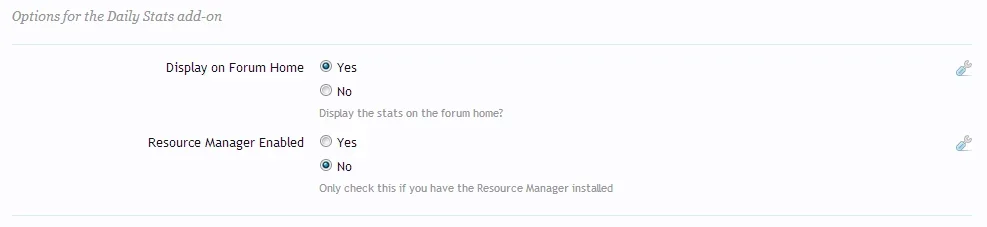

That is coming out as well based on an option to enable the RM stats, which is disabled by default (given it's an add-on and not core stats like the rest)
