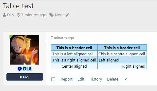

This the equivalent css for XF2, only tested with the default style, put it on extra.less template
CSS:
.ctaBbcodeContainer
    width: auto;
    max-height: 600px;
    overflow: auto;
.ctaBbcodeTable
    border: 0;
    font-size: 0.85em;
    border-collapse: collapse;
.ctaBbcodeTable tr.ctaBbcodeTableRowTransparent
.ctaBbcodeTable tr.ctaBbcodeTableRowOdd
    background-color: @xf-paletteColor1;
.ctaBbcodeTable tr.ctaBbcodeTableRowEven
    background-color: xf-intensify(@xf-paletteColor1, 10%);
.ctaBbcodeTable tr:hover
    background-color: @xf-contentAccentBg;
.ctaBbcodeTable td
    border: 1px solid @xf-borderColorFeature;
    padding: 1px 4px;
.ctaBbcodeTable td.ctaBbcodeTableCellHeader
    text-align: center;
    font-weight: bold;
    background-color: xf-intensify(@xf-paletteColor2, 5%);
.ctaBbcodeTable td.ctaBbcodeTableCellLeft
.ctaBbcodeTable td.ctaBbcodeTableCellCentred
    text-align: center;
.ctaBbcodeTable td.ctaBbcodeTableCellRight
    text-align: right;

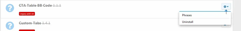

Hey thanks for this. I'm using CTA Table BB Code 1.1.1 but I am not sure if I can enable it to work with 2.0? Care to share how you made it work on your site? I see my as legacy but not sure what to do from there?
Thanks.
Is there anything else involved besides adding the code in the template? i see that the bbcode are available on ACP but it does not show up on help page since the addon is not enabled (legacy addon)
I have exactly the same issue.
Not really sure how to activate it.
