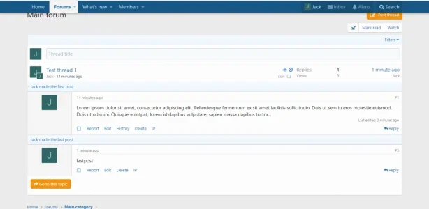

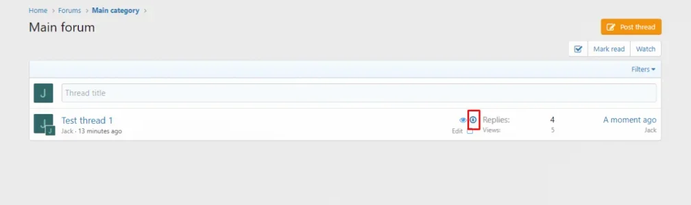

Okay, I have an addon that allows users to preview threads on the thread list. Addon adds an icon that you click, which opens the preview. Addon is here, https://xenforo.com/community/resources/ozzmodz-thread-preview.5754/
Icon Example:
Preview Example:

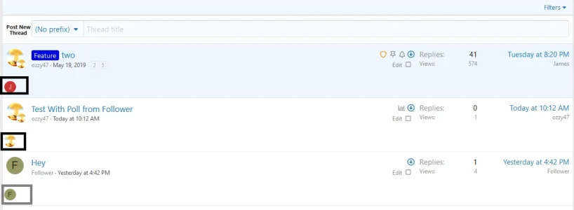

Now this works in 2.1 and 2.2 but in 2.2 there are display issues. It moves the last poster avatar to a new line.
This is of course unacceptable. This is the bit of CSS that is causing the layout issues.
CSS:
.jpreviewreplace {
    display: table-caption !important;
    width: auto;
    caption-side: bottom;
It has something to do with, display: table-caption !important;
I just have no clue how to solve it.
Hey bud, after going through the template you stated, I was able to locate the issue, it is as simple as doing the following;
Replace the following code;
CSS:
.jpreviewreplace {
    width: auto;
With this one;
CSS:
.jpreviewreplace {
    list-style: none;
    margin: 0;
    padding: 0;
    float: right;
    margin-left: 5px;
In the "j_threadpreview_post.less" template.
Sadly no one helped you on time, I hope you had already fixed the issue, if not, I hope I was of some help. Best of luck with your forum!
