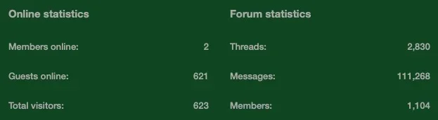

You could throw a pretty decent party with that amount of guests.But only 600 guests on my forum - which is good![]()

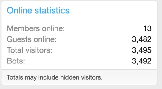

I'm still wondering about these numbers. This sounds even worse than the worst times here on the XF forums back in spring this year. Way worse. Are these bots or are these rather requests? But even then: Your forum is decent, but in comparison to others on here not that huge:Today Cloudflare is showing 1.02 million bots trying to hit my site. Recently it's only been about 250k.
About 180 on average.You could throw a pretty decent party with that amount of guests.What amount of guest used to be normal on your forum before the bot waves started, so probably 1,5 - 2 years ago?

Edit - yes it's request numbersI'm still wondering about these numbers. This sounds even worse than the worst times here on the XF forums back in spring this year. Way worse. Are these bots or are these rather requests? But even then: Your forum is decent, but in comparison to others on here not that huge:
How old is it?
Im comparison: Mine is four years old and has roughly half as many messages, double as many threads and four times the number of users. The largest number of guests on the forum I ever saw was 1800 in spring last year during a bot wave from Hetzner. I have started to block bad requests already two years ago and never stopped since. The highest number of IPs that tried to reach my forum within a 24h period was something like 12.000 and clearly, more than 10k has been an exception that I can count on one hand. Normal over the last months has been 1.200 - 2.500, atm bots seem to get nasty again, so numbers between 3.000 and 4.000 are kind of normal atm with about 7.500 being the peak over the last weeks. Most of them do never reach the forum anyway and are blocked upfront completely.
So either bots like hamsters way, way more than my forum topic or there must be another difference that makes my forum less attractive for bots than others. I mean: I clearly won't complain about that- just wondering what the reason may be for this immense difference.

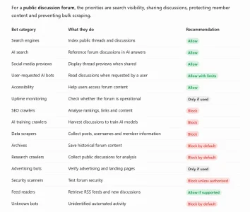

GPT categorisation of CF allowed bots.

If you wanted to get a little broader, fairly safely, with my rule, you could expand to:
Code:cf.client.bot and ( lower(http.user_agent) contains "googlebot" or lower(http.user_agent) contains "googleother-image" or lower(http.user_agent) contains "bingbot" or lower(http.user_agent) contains "applebot" or lower(http.user_agent) contains "duckduckbot" or lower(http.user_agent) contains "bravebot" or lower(http.user_agent) contains "yandexbot" or lower(http.user_agent) contains "baiduspider" or lower(http.user_agent) contains "yeti" or lower(http.user_agent) contains "petalbot" or lower(http.user_agent) contains "slurp" or lower(http.user_agent) contains "mojeekbot" or lower(http.user_agent) contains "kagibot" or lower(http.user_agent) contains "oai-searchbot" or lower(http.user_agent) contains "claude-searchbot" or lower(http.user_agent) contains "perplexitybot" or lower(http.user_agent) contains "duckassistbot" or lower(http.user_agent) contains "mistralai-index" or lower(http.user_agent) contains "chatgpt-user" or lower(http.user_agent) contains "claude-user" or lower(http.user_agent) contains "perplexity-user" or lower(http.user_agent) contains "mistralai-user" or lower(http.user_agent) contains "meta-externalfetcher" or lower(http.user_agent) contains "facebookexternalhit" or lower(http.user_agent) contains "linkedinbot" or lower(http.user_agent) contains "twitterbot" or lower(http.user_agent) contains "telegrambot" or lower(http.user_agent) contains "discordbot" or lower(http.user_agent) contains "slackbot" or lower(http.user_agent) contains "bingpreview" or lower(http.user_agent) contains "microsoftpreview" or lower(http.user_agent) contains "googleimageproxy" or lower(http.user_agent) contains "whatsapp" or lower(http.user_agent) contains "pinterestbot" )
